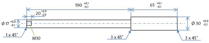

Fitting R100 GS forks from a paralever model into a ST or G/S frame is relatively straightforward. The steering stem, tapered bearings are the same. The steering stops all line up. I wanted to use my R80G/S wheel and found that drawings exist on the interweb for a custom front axle that fits the larger diameter of the lower fork legs but matches the smaller bearing size of the older wheel. Suitable spacers are included in the drawings though I found out that they are shown the wrong way round.

Can you send me a link for the GS spindle.
I have some GS forks to consider fitting.
In image 1 bushes 3 and 2 should be transposed. In other words bush 3 should be to the left of the image, right hand fork side.

Hi Paul, I'm looking to upgrade my ST in the same way, using the original 19" wheel.
What is the source of the custom axle drawings and where did you source your axle and spacers from?

Please send me your email address by personal message and I’ll mail the drawings. I gave them to a pal who uses an engineering firm locally to machine them up.
I've finally fitted my GS forks and ST 19" wheel , having had a custom axle made to the specs supplied here by @scooter paul (thanks very much Paul!)

Hi am trying to do the same exact thing on my G/S. I have a full R100GS fork setup but dont have the wheel and glad to read that I can use my G/S wheel. Can one of you send me the specs for the spacers? Thank you so much!!
NOTE: I just read the whole thread and saw the pics of the spacers.. thank you!!

I'm still running my ST with GS forks and its original 19" wheel using ScooterPaul's diagrammed custom axle specs.
It works a treat.

perfect, was going to see if I can get it made.. I did not want to try to find a R100GS front wheel and glad to reuse my G/S 21" front. did you use stainless?
