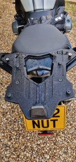

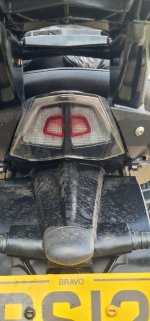

I fitted a GS rear mudguard to my RS recently. It looks okay but is slightly offset to the left which apparently is due to the tyre width being different on the RS.
It seems to make a difference to the amount of muck thrown all over the top half of the bike (the main problem in my opinion) although the swingarm still gets lathered although the bike had panniers fitted which might have caught some of it.

Not sure how you would fit a second nut as you attach a threaded spacer to a stud on the bike and bolt the mudsling to that. I just used blue locktite, a nylock nut and washer, but can't remember if that was standard? though I've done less than 2k so far. As far as the cable ties are concerned they are more than up to the job, having fitted a mudsling to 3 GS' and my RS without any problems. If you thread the cable ties correctly you can position the cable tie head so it's out of the way if the aesthetics are important to you. I had the Puig hugger on my GS, it didn't fail maybe because I'm not a high mileage rider but it did start making some strange banging noisrs so I took it off. I didn't fit one on my RS because of this and the experience others have had as TBH it didn't make a huge difference in my experience on my GS, yes it helped but it didn't solve the problem. I've since found the perfect solution.....don't ride in the rain/on wet roads 🤣 BTW the Motorrad colours are the bestist. You might find the OE screen is shoite. I put the Puig touring plus smoked screen on mine which is a big improvement, others fit the MRA Vario one.20240620_142332.jpg
While the Aussie wide conversion will stop some of the shit being thrown up it won't stop it all.
