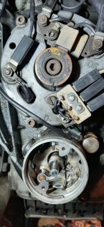

My 81 G/S has been fitted with a Sparkrite SX4000, it appears to use the points as a low voltage switch to trigger the "electronic ignition".
Who ever fitted it removed the mechanical advance/retard mechanism so all I have in the bean can is the points, to my way of thinking this type of system still requires some form of ignition advance and retard, can anyone confirm or deny this please ?

advance /retard is probably done in the electronics . the points do the switching with very low current , so wear on the points face will be vvv low.

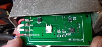

I had to open up the Sparkrite to try and identify what is was, I am no electronics engineer but it's not made to the highest standards and from what I have read about them I'm surprised it still works, still looking for a recommendation on what to replace it with if anyone has a suggestion.

My engine number returns a build date of Feb 81 but it clearly has points in the bean can, so I guess in the 45 years it has undergone a lot of changes.

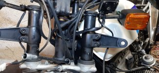

I do suspect front end damage at some point as that would explain it having the wrong clocks, headlamp and incorrect mud guard, perhaps the front of the engine also took a knock, the plan is to get her at least looking like she should, with a few modern upgrades.

I didn't take many photos, but here is the bike as I brought it with all the wrong bits on the front.

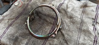

With the headlamp removed, plastic spacers allowed water ingress so surface rust on the chrome, quick fix was some rubber gaiters, future me can worry about a re-chrome in the future.

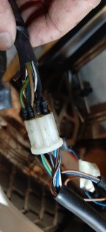

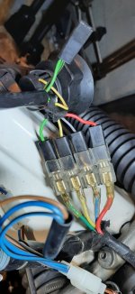

It's had a new loom at some point, but a fair bit of bodgery to get ST clocks working.
The Sparkrite, had to find out what it was by googling the number on the PCB
Eventually found the most expensive bit of bent tin on the planet, and got bent over again on customs charges to rub salt into the wound.
