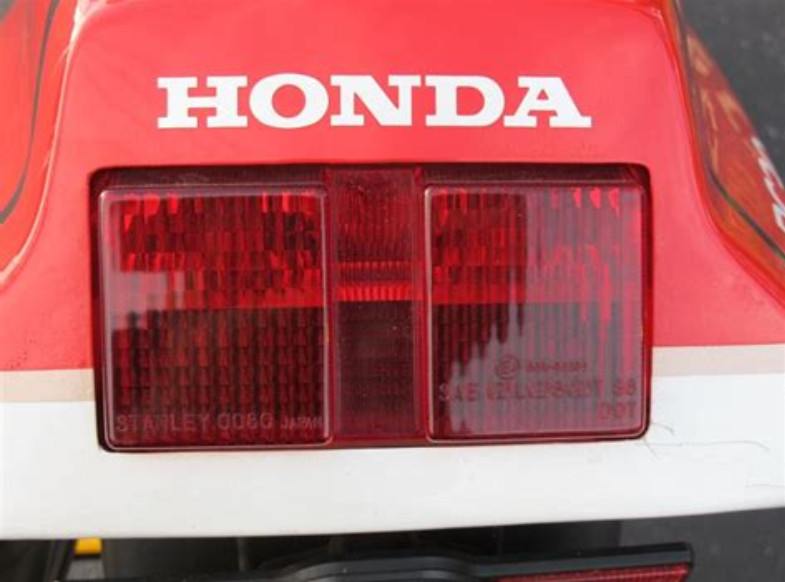

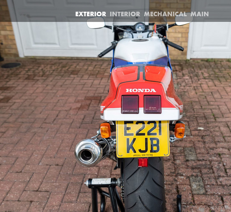

if you are old enough - when the RC30 was first at the Birmingham NEC it has a very cute tail light housing - then UK ones came with the web cut out making it look like a pile of junk - so it met our rules
a real one
