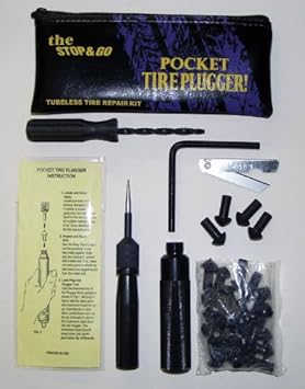

Get one of these, they are awesome. I keep one of these and a compressor in my top box. Works well with the damage caused by screws / nails. Happens a lot around London.
http://www.amazon.co.uk/STOP-POCKET-TYRE-PLUGGER-KIT/dp/B003VE0ZL6
That's exactly what I've just bought.:thumb I've got a small under rack bag that this will go in, with some CO2 cartridges.:beerjug:

Tried the Stop 'N' Go, go the plug in fine but it was leaking air very slightly, tried another plug but still no luck. Took it to a mates car fitting shop, he was concerned about damaging the rim, went to another place who took the tyre off then refused to fix it or remount the tyre on the rim :blast went back to mates garage who then repaired it and then drove to another garage where they had the correct machine to remount it...... got it home and discovered the repair wasn't effective :blast
So a new tyre is needed. I'll check to see what it looses over night, if it's only a few lbs then I might run it for local riding.
Yep the Stop 'N' Go kits and even just a couple of CO2 canisters will certainly get you home or to the nearest garage :thumb2

The only problem with the stop n go is, where do you get replacement CO2 cylinders ?.
