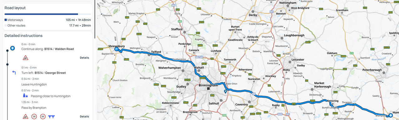

I would like to be able to make a quick analysis of a route - to break it down by road type or similar.
For example, on a 250 mile route it would be great to know how much of it was motorway, A road, B road etc.
The ViaMichelin offers this facility, and AI suggests a few alternatives where a GPX file can be analysed, but I have not had much success with them.
Example from ViaMichelin:
Any info would be welcome.

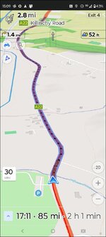

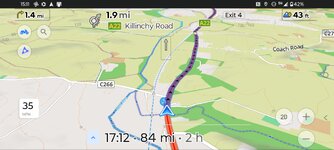

OSMand+ does a bit of what you might be looking for.
It navigates tracks but provides analysis of the roads (or not) used. The top graph is slope and elevation
When you hit details on each element it gives additional information. This is the detail on road type. So in this example about 100 miles of this 300 mile route are on faster roads
I subscribe to it because it works on Android Auto and only Costs £10 but predominantly use MRA for planning and navigation. But I do use OSMand+ for navigation as well as I like the look of the maps and on little back roads it give warnings of crossroads and stop signs when on some boreens right of way isn't exactly clear. Also it has modes for other uses like cycling walking and horse-riding if that's what you are into!. The BIG downside of the app is that because it is so configurable the user interface is way more complicated than MRA. Also the way it handles via points is completely different than MRA or BAsecamp/Garmin which are fairly similar. I like it, but the effort required to use it effectively means it isn't for everyone.
