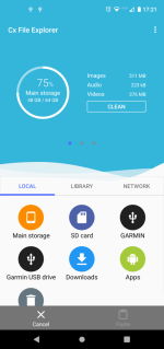

3. Open the phone and navigate to its file manager. This varies depending on the make of mobile phone/personal choice but you should see the Garmin as an attached device. The Garmin USB device is just the SD card if you have one in your unit.

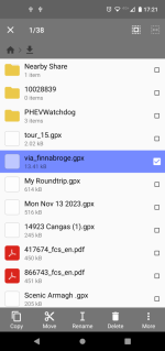

4. I had downloaded a route from MRA routeplanner onto the phone so I hit the downloads button and selected the file I wanted to transfer.

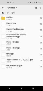

5. And copied it into the Garmin>GPX folder
6. The file will appear on your imports on the device.

Open Downloads in the Tablet.
Select the file and a ✓ appears.
“Options” will appear on the screen.
Select Copy ( it wants to know where you want it copied to)

Select Garmin.
Select GPX.
These three steps are key. The file must be saved into the GPX folder in the USB.
Only now, click Copy.
