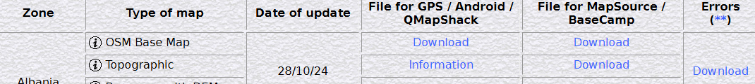

In order to test an easier way to put fresh mapping on a CN Garmin device I had a look at some of the “Ready Made” mapping sites. There is a Wiki on what is available here:-
https://wiki.openstreetmap.org/wiki/OSM_Map_On_Garmin/Download
I downloaded the Ireland/GB maps for testing purposes from here, just because I’d had a look at these sources of mapping before.
https://www.freizeitkarte-osm.de/garmin/en/westeuropa.html
And here.
https://alternativaslibres.org/en/downloads.php
But as you can see from the wiki above there are loads of sources. As with all sites be careful what you are downloading and if possible scan the files for nasties before you use them.

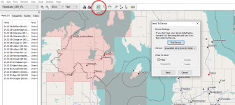

To get the map onto the device
Mapsource
In Basecamp Maps> Mapinstall

The maps can be loaded onto an SD card via Mapsource or Basecamp as outlined above or loaded into a folder called “Garmin” in the root directory of the card with the file name gmapsupp.
I like to load my maps into Basecamp so that if you plan routes on custom maps that match the maps ticked in the Nav the routes don’t have to be recalculated as they would if you planned on Garmin maps but tried to route via a custom map.
