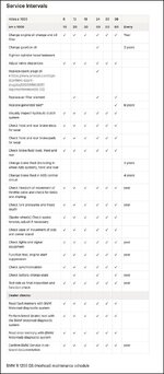

I have this (for my 2007 hexhead) as a reference in the place where I keep track of all the work done on my GS.
I too started doing the basic servicing myself on this bike. Bigger jobs --> professional mechanic.
I think I extracted this from the RepROM. Can potentially check for 2010.
For the last couple of services I did myself I - mostly for fun - generated the service sheet from the RepROM. :) Kinda handy when ordering parts.
