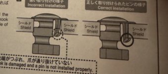

And what the actual fuck is this that was in the box ?
I don’t have such a pin, and even if I did I haven’t got a fucking clue what the instructions are trying to say .

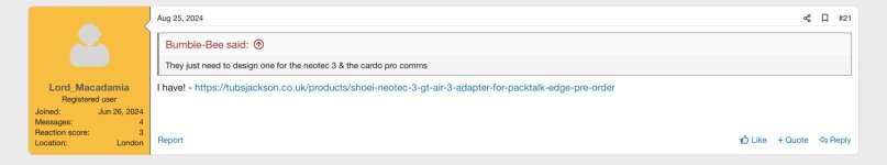

So a quick search on Google came up with Tubs Jackson who make a 3d printed adapter for the Neotec 3:
Bit pricey , I think at £40 ! But I did get it for £34 on a Black Friday deal .Still didn’t recognise Guernsey is VAT-free.
Oh well, don’t mind paying for good kit-and I’m pretty impressed with it , as it slots into place and sits snugly on the Neotec 3 , rather than simply being stuck on like the Cardo version on the 2 :

So definitely recommended, and I’m pretty sure that the guy behind the company is on here .
Edited to add, he is:
Those are the clear plastic pins that hold the pinlock inside the visor, hence the name pinlock

Yeah, but the pinlock pins are already fitted to the visor,though they do provide a spare set.
BUT those instructions don’t make any sense .Whats the black piece circled ?
They’re showing you how to fit the pins if you need to change them for example
The picture you’ve circled shows a cross section of the visor (shield) with the pin not completely seated
In the last picture they show you how the hook holds the pin in the shield when correctly fitted,
The hexagonal part at the bottom allows you to turn the pin to adjust the tightness of the anti fog screen, I think there is a plastic tool in the bag with the stickers etc.
The cam part between the hexagon and the shield, where the anti fog screen fits, is offset to provide the adjustment when you turn the pin
