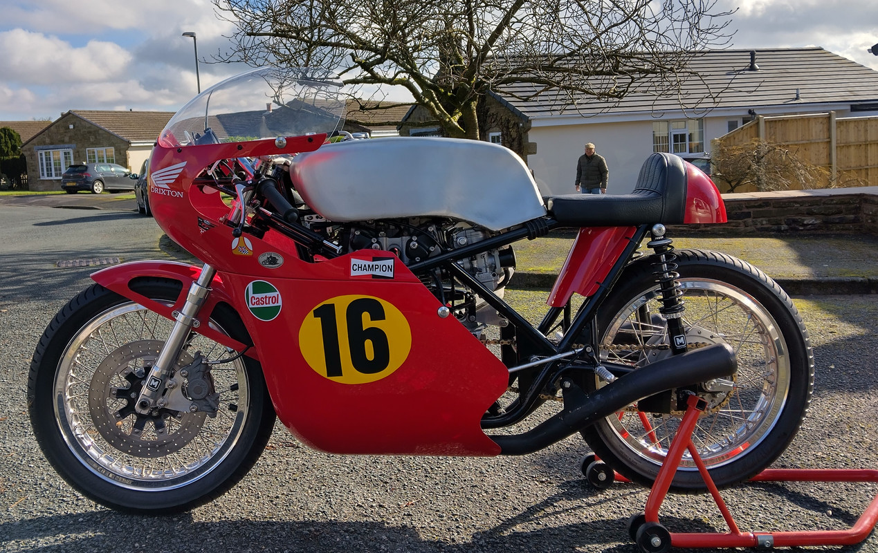

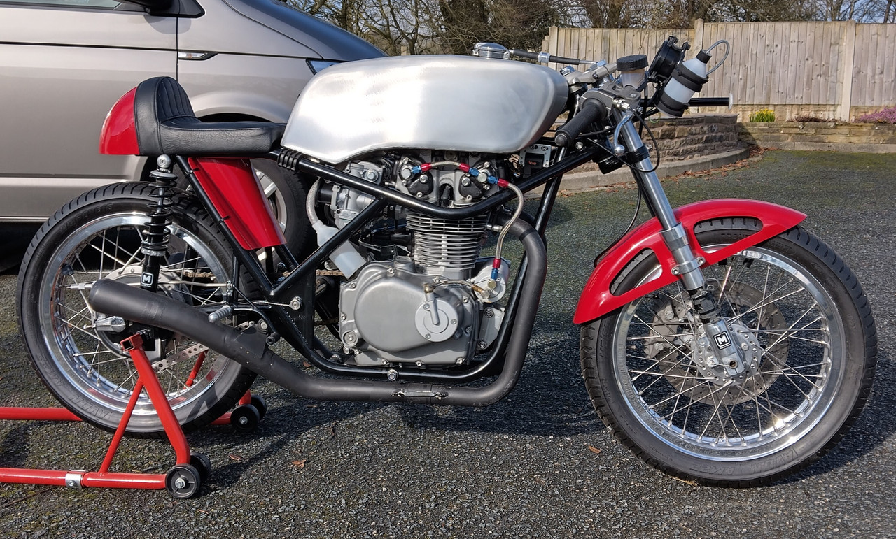

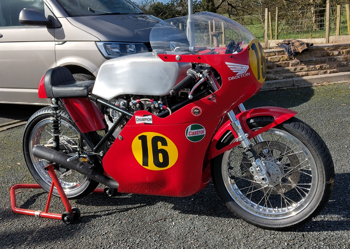

How does the 4ls performance compare to a disc brake? Certainly more visually pleasing.! It is a piece of art. Even my T500 brake looks good (but not very effective..!)
It's much better than the disc brake that was used on Triumphs from 1973 onwards although I haven't used it in anger so to speak. It's a full-race brake intended for classic racing and I'm a bit wary of it being too much for the Dunlop TT100 front tyre although the weight of the Trident should help. I think the T500 brake is the same as the fitted to the T250 so has a bit more weight and speed to deal with. The 4 leading shoe brakes fitted to the GT550 and GT750 are great brakes too. The brake and clutch levers on the Trident are GT750 items.
I built this one just as Covid started followed by a house move and so it has never been ridden yet. Started as a £600 Ebay purchase, all that remains are the crankcases, crankshaft, barrels, head, some gearbox parts, fork yokes and wheel hubs. More pictures and info here :- https://www.carandclassic.com/l/C1736898
Very nice No 6 ; did you have any bother with the hair spring valve gear; :beerjug:
I never ran it with the torsion bar system, it's been converted to coil springs. It's got Megacycle high-lift camshafts and they recommend not to use them with torsion bar valve springs.

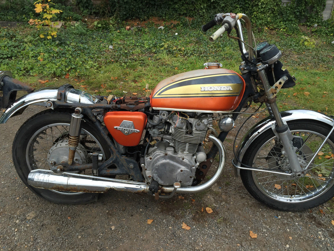

.... and damnit .... work offered me a trade purchase on this :) ... so no. 6
