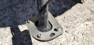

My camel toe has the bolts welded in place so am unable to lengthen them to accommodate a puk. I didn’t quite follow the photo in the other link of the string attached puk to be used when needed. Does that mean you have to slide this puk under the side stand base whenever it leans too far?

You don’t need the camel toe. I drilled 3 holes in the existing side stand bottom plate and attached the ice hockey puck.done
Or post a picture of your existing camel toe stand, let’s have a look, screws need only to be rather short..
here is a photo.

I think you have a point, there is some lateral play, but I haven't taken it off to examine exactly what is worn.
I would like to put something over the stop flange so that it didnt lean so much but this would probably require welding.

Don't park with the stand down hill, park square, facing up hill, or face the other way so the excessive lean of the side stand is cancelled out by the camber of the road.
It doesn't look like the bolts are welded in to the pad, get longer bolts, probably countersunk allen heads, you could experiment with different thickness spacers.
Spacers would only increase the lean by putting the side stand further out from the bike.
