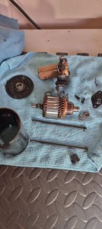

Noticed over the last couple of days the bike is taking longer to start
Normally its two revolutions and it fires , but its now between 4 and 6 revolutions
Battery is a motobatt put in about 20 months ago , normal sluggish turnover, then spins freely but now up to 6 revolutions before it catches
New plugs etc at the last service, TPS changed about 6 months ago
Exhaust damper is open and still cycling fuel consumption is normal 48.5mpg
On my single cam the starter was borked at 26k , The TC is currently on 22k
Only thing i can think of is the temperature is dropping to sub 10c at night now, other than that i'm stumped ?
I had a sluggish turnover on my 2010 GS. I read on here about cleaning out the old grease and replacing it with new so I gave that a try before buying a new starter motor. It worked much better than expected and saved me having to buy a new one. The old grease had almost turned into a plastic type paste. Easy job just need a piece of pipe or cardboard to guide the brushes back into place.

Once its spinning its fine, albeit it takes more revolutions to fire up
I may pop the starter out and have a look see/ lube
