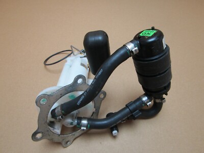

Got the front / fuel tank fairing off - only a few screws!
and I could see the tank and fuel pump assy better.
I did a start and it was getting wet around the fuel pump, dripping fuel.
Tank off, drained, fuel pump and found a crack in the plastic housing.
Will likely need a replacement fuel pump. If its stupid expensive, we have some sealant at work, but a replacement assembly will be best.
Hairline crack on the left side vertical 'tower'
£50 for a second hand pump from James Sherlock with a 6 month guarantee
Not sure if it will be economical to ship to Australia mind :-(
Thank you
Mmm, thats about au$100.
I got quoted au$488 for a brand new one this morning, be availble for pick up next week.
Mmmmm, will give them a call this evening and see.
Based on the mode of failure for this item, and the plastic housing, tempted to go for a new, but at a 1/4 of the price, its tempting.
New….
But then it’s not my money.
Or my bike being covered in petrol.
I've had four of these bikes ranging from a brand new one to a well used one that had done an overland African trip and I've not seen the fuel pump fail like this before . The fact that there are so many secondhand pumps for sale on line also suggests a low failure rate . I guess you pay your money and take your chances - a six month guarantee for AU$100 or a 2 year guarantee for AU$488
