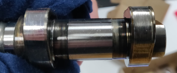

Hi all. I took the LHS valve cover off today to check the valve clearances and to look for anything untoward….nothing obvious I must say, and cams looking in great condition too 👍
It sounds perfectly normal to me. The left will sound louder with the tensioner there, or at least has in the LC's I've owned. My own was bought with little over running in miles and at approaching 9K miles now it sounds like a blacksmith's forge on overtime when warm. Much noisier than my older air heads. Some have reported a lessening of the ticking noise with the change of camchain idler wheel as bmw offered a slightly large diameter one to take some of the slack out of the chain. Not sure if this was to fit just the shiftcam engines or the 1200's though.
