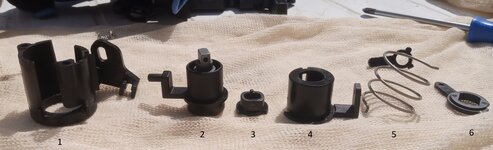

Before I reassemble the whole box testing the lock is an obvious thing to do......but I'm not happy. The release works 100%, beautiful perfect but the open is not good.
When you press push to open the part of the left should slide partly into the part on the right and then when you let go release. But the part on the left sticks, it's a really tight fit like good quality Lego bricks.
The order of assembly.
Number 2 goes into number 1, the extruding part goes out the opposite side to the slot facing us
Number 3 goes onto number 2 and can only go on in 1 orientation
Number 4 goes on the top of number 3 and takes advantage of the slot facing us shown on number 1.
Next goes the sprint which locates into a little slot on the base of number 4
Number 6 would go next followed by the 'cap'
The small black piece behind the sprint slots into number 6 and locks with a mounting point on the cap (not shown)
Do I sand down part number 3 to slide smoothly into part 6.......or did I miss something?

Sorry Neil-- cant give a definitive answer and i don't have a complete lock mech to check. I don't think sanding down any parts is the way to go as I don't recall any bits being a tight fit , certainly not tight enough to need sanding.
