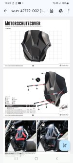

Cyber Active member UKGSer Subscriber Joined Sep 26, 2020 Messages 254 Reaction score 16 Location Hampshire Mar 17, 2024 #1 Anyone help me with the torque settings and if there is a sequence on the front cover? I’m guess not very much but I don’t have that setting on the wrench…. I’m needing to remove the splash guard the previous owner fitted,.. Attachments IMG_0628.jpeg 74.3 KB · Views: 17

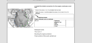

Bigcats Well-known member UKGSer Subscriber Joined Nov 19, 2022 Messages 12,521 Reaction score 12,555 Location Portsmouth, England Mar 17, 2024 #2 This is what I have This is for a K51 engine cover!!
leadfarmer He / Him / That Fucker UKGSer Subscriber Joined Nov 5, 2015 Messages 13,347 Reaction score 5,478 Location Dark Side of the Moon (Haute Loire) France Mar 17, 2024 #3 I think 12NM, but it seems there’s a sequence too, hopefully someone will have the workshop manual Section 11 14 http://jimvonbaden.com/Wethead%20Torques%204.pdf
littleade Elderly twat UKGSer Subscriber Joined Oct 10, 2015 Messages 5,783 Reaction score 10,530 Location worcestershire england Mar 17, 2024 #4 The Wunderlict xtreme front engine cover is 10nm, so guess that's the same for just the cover?
Cyber Active member UKGSer Subscriber Joined Sep 26, 2020 Messages 254 Reaction score 16 Location Hampshire Mar 17, 2024 #5 Perfect, thanks all…. 10NM it is then. Cheers
