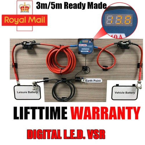

I do however have a very large leisure battery inside something like this (Picture below)
I am therefore looking for a means to trickle charge, from a 12v battery.
This far the best I can seem to find is something like this:
Suggestions welcome!!
Thank you
1692895569238-png.28723
You’re going to struggle with that, as the big battery will only have a few more millivolts than the bike battery until the bike battery is somewhat discharged - chargers are normally working from a higher voltage source and current limited.
And anything active will waste energy as heat, though you could run a charger off an inverter. Doesn’t seem like a good plan.
I suspect if you simply connect the big battery in parallel with the bike battery, it’ll do what you want as your tracker etc would have to run down both which will obviously take a long time.
You can then take the big battery for a recharge eg once a month and the bike will be ok overnight or whatever until you reconnect them

You should use big cables if you connect up the batteries in parallel as suggested. If the bike battery fails, the big one will dump into it at a high rate and frazzle little charger spec cables.
I personally wouldn't leave them connected like that at all.

I would put a low amp fuse eg 3A in both lines on the big battery side, just before the flylead.

With two batteries connected in parallel the one with more charge will feed the other until the voltages match. The higher the voltage difference between the batteries the more current will flow but as most 12V batteries have a small voltage change between full and flat this will probably not be a problem. As said before a fuse is a must as a short in one battery will deffo lead to stuff melting. You could use a current meter to work out how long the big battery will last.
