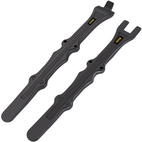

Any tips regarding tyre levers please ?
Im doing a trip on my G/S which has tubed tyres , so i thought that i might get a good set of tyre levers just in case i get a puncture.
Im not sure if its best to carry spair tubes or just take patches .
Ive got a can of that tempory tyre repair stuff that you squirt in through the valve but not sure if its any good ?
Any advice would be most welcome .
Thanks
Better tubes than patches IME but ideally take both. A 21" tube will go in the rear if you're pushed for space.
Most tyre levers will work OK, but what really helps is practice changing tyres. Long "Michelin" types with a curve in them work best at home, but are too big to carry on a bike really. For that I favour old school "Dunlop" style levers like these pictured. Plenty of other options from firms like Motion Pro etc.
Those cans of gloop claiming to fix punctures almost never work with tubes.

You can get away with two levers, but it makes the job so much easier with three.
You won't need the bead breaker element of those levers with tubes, so might as well get some simpler and cheaper levers.
...and as John RTW says above, 3 levers are better than 2.
