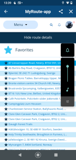

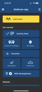

In the app >hamberger on left hand side> Favourites >click on favorite add to route or route to favourite.

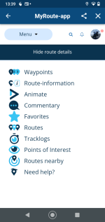

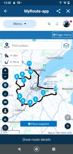

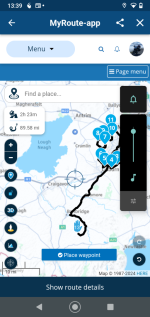

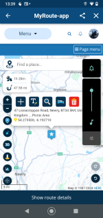

The app lets you route to the favourite.....not further input required. To add it to the existing route you open the route lab in the app. Open the show route details at the bottom of the map screen> click on favourites > click on hide route details and add the favourite to the route if you want to.

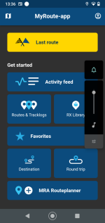

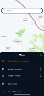

What I'm talking about is using favourites in the MRA Routeplanner from the app - the button at the bottom
This takes you into the new routplanner app
The 3 line hamburger brings up this menu. What I’d like to do is use this app, which is quite good, to create a route using favourites I already have in MRA

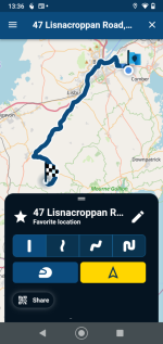

To use a favourite as a destination on your phone
Click on your favourites and off you go.
To alter a route
Open the route and open up route lab at the bottom of the page.
Click show route details.
Pick your favourite
Click hide route details
Click your favourite as before and add it to your route
So it can all be done from the app but its a bit clunky.
Except not really. Opening up favourites on your phone only navigates you from where you are now to that favourite - which could be useful I suppose. It won't, as far as I can see, navigate from one favourite to another - that needs route lab.
