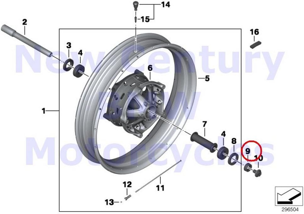

can anyone help.
I have looked at the Haynes manual and the internet but no joy
This fits in between the front wheel bearings. Does is just sit there and is the end clip/washer the correct way round? I have the 2nd clip/washer loose on the bench.
does this help
