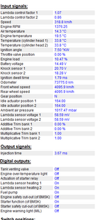

Hello , I'm looking for any tips on what to check next with the bike. Symptoms are poor starting from cold, requiring an open throttle. Once initially warmed it will start closed throttle. It idles with an odd miss/pop every once in a while. On it's test run after the reassembly it ran fine, apart from the idle.
Items replaced at rebuild: Full set of O.E coils, Lambda's, plugs, crank sensor, fuel pressure reg and pump were also replaced with Quantum parts . Valve clearances checked. Injectors both spray a good cone.
Once running it appears to be running far to rich. Eye streamingly rich. I am now wondering of its one of the ecu's
