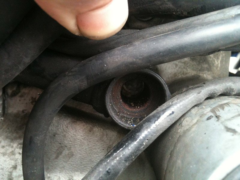

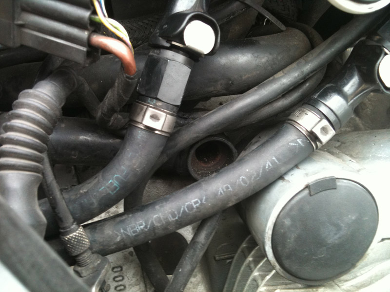

Yikes! Missing bolt!
could you not -
drill a whole in the broken stud tap new new thread in it and wind a new smaller bolt in it.
thus fixing it to the frame again.

Just to double check, I need a 35mm M8 bolt?
The hole is 35mm deep on my R1100, you dont want a bolt the same as the depth, its all back together now so I cant give an exact measurement of the bolt, But 30mm should be fine, (M8), take the one out the other side and measure it.
Bolt out, all fixed.
