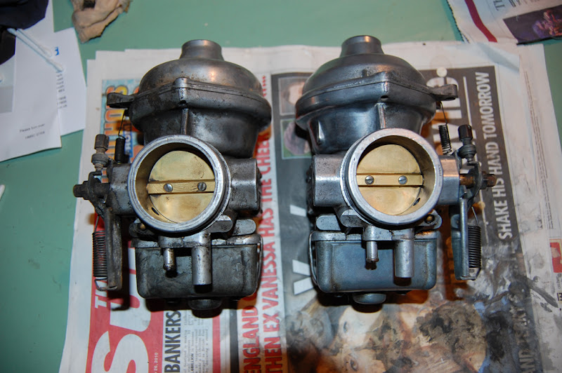

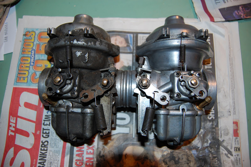

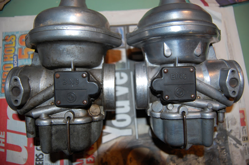

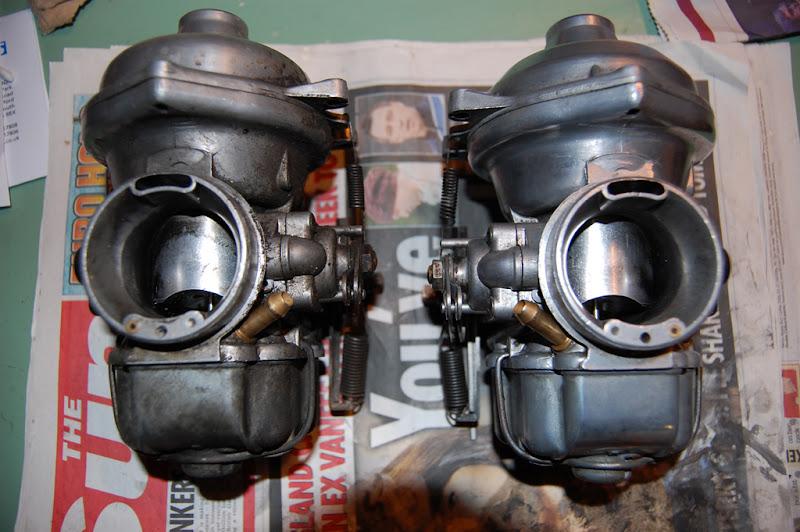

Part 1: Carbs removed and refurbished
I've gone for a full strip, clean and replace of all of the perishable parts.
* Stainless top screws
* Float bowl gaskets
* Choke assembly gaskets
* Throttle springs
* Choke springs
* Rubber seals
* Jets
* Needles
* Diaphragms
Part 2 to follow shortly. :)
One I prepared earlier
What make is the screen on your GS?
great start look forward to reading more. How did you clean the carbs?:thumb
Cheers. :)
I started out by stuffing the Ports with newspaper - then gave them a good spray with this stuff:
After wiping the gunk and grease off with a rag, I soaked them in carb-cleaner.
After that, it was a case of cleaning and greasing the throttle and choke assemblies, replacing the gaskets - then fitting the new internals.
Finally a nice polish with a bit of Brasso. :thumb2

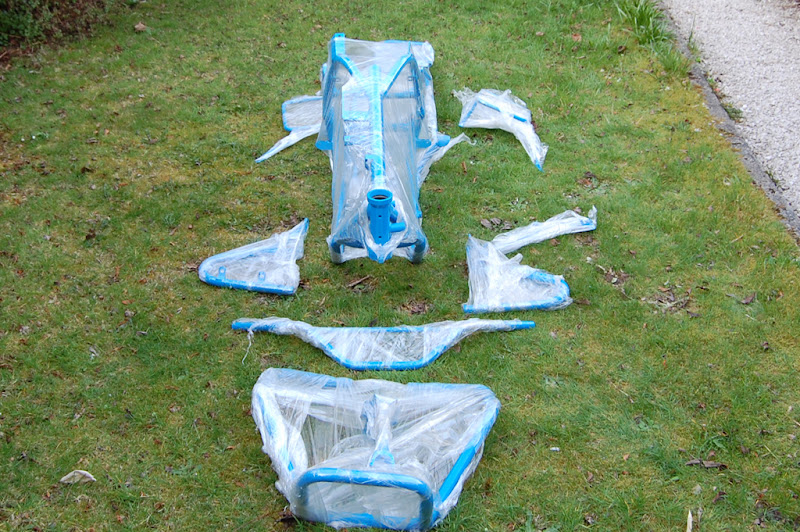

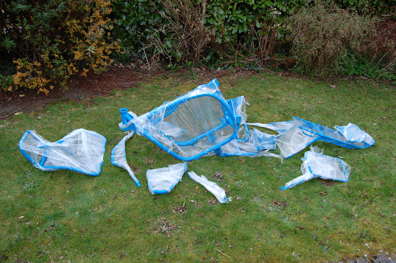

Time for a couple more long-awaited photos!
Today I got the frame and some other bits and pieces back from the Powder-Coaters.
£200 got me a full strip down of the frame and all of the other parts; (removing the old powder), all the necessary prep and a full coat of blue Powder. The new 'Kalahari' colour scheme is really taking shape!
Apologies for the parts still being wrapped in plastic, but I'm leaving her this way until the re-assembly commences tomorrow :thumb
