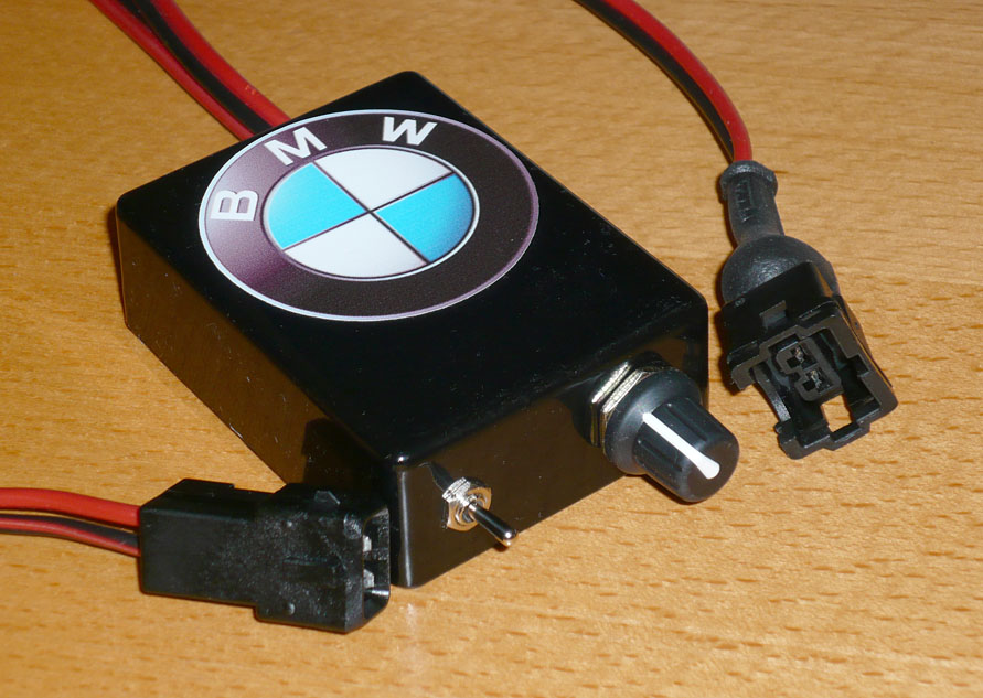

Based on the thread over on Pelican Parts, I followed the destructions and bought the bits from Maplins and assembled this the other day:
It has a variable pot to alter the resistance - inside is a fixed 10K Ohm resistor with a variable 20K Ohm one - so I can alter the resistance manually from 10K to 30K by rotating the knob thingy. The switch simply allows me to by-pass the thing entirely in the event I want to disable it for whatever reason. The tacky sticker I bought at the NEC last year.
This was a doddle to build - it cost me £7 in bits and half an hour behind a soldering iron. I haven't tested it yet as I'm waiting for the weather to warm up a bit. I'll let you know how I get on!
Cheers,
Fin.
