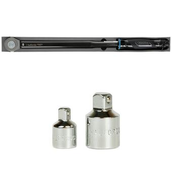

Found this one that should do the job.
Although I presume I can take a half inch drive down to 3/8 with a suitable socket.

I'll go to halfords so I can have a look at them as the Sealey one is online.
If you’re looking at the Halfords pro range, get 2. The small one covers up to 60 Nm, the 300 then covers 60 to 300 Nm.

Anyway two ordered from Halfords. Told the chief money operations manager they were a necessity for my safety on the bike. ;)
