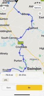

This route has round 10 waypoints that went over correctly to my Garmin, but this is how it shows in the Beeline appIMG_4894.jpegIMG_4894.jpeg
Indeed, the waypoints seem to be missing in your screenshots.
Have you tried using the ‘Compass mode’ setting?
It’ll be interesting to see how Beeline reply.
