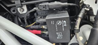

So I bought a new starter relay and swapped them (£60). Took 20 mins and remember to remove the -neg on the battery first otherwise you WILL weld your tool to something because the +pos on the relay is in a nice awkward position to get to. However really easy to swap out and its not actually bolted down to anything its clamped in at the top behind that plug that is just above the relay.
I also replaced the M6 nylon nuts (10mm socket) and they are specc'd to 6NM according to the service manual and it says also use loctite!
Then I have coated all the exposed metal with some terminal grease
This is the old and you can see some corrosion on the cables
Here is the new and you can see in the top right corner of the replay it has numbers stamped (++2321) on it so I am guessing they are reversion numbers?? but only guessing.

How bad was the corrosion on the old relay? A good shout to replace it if corroded as it causes high resistance, not worth being stranded for £60. My starter relay is spotless and no volt drop on a cold start, need to try a hot start sometime.
