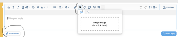

might be because you are a non subscriberAlso i would upload a picture, but i can’t workout how to upload from my phone. Can only seem to be able to attach links.
