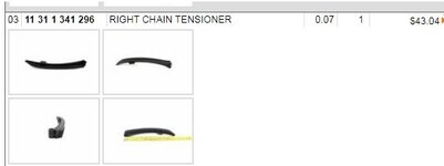

I am looking at replacing the cam chain tensioners on my 09 GS. I have looked at the realoem part catalogue and found the part numbers but when I use those numbers I can;t find anywhere that even recognises the part number for the right hand tensioner.
The left hand number seems fine and Motorworks have them in stock. The number that I have for the right hand tensioner is 113118530331.
Does anyone have any other numbers or info on that right hand cam chain tensioner?

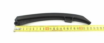

Looks like this might be what your after, part# 11311341 296 Right Chain Tensioner for 09 r1200GS
Hope it helps.
Added Information:- for Left hand Tensioner part# 11311341 295
