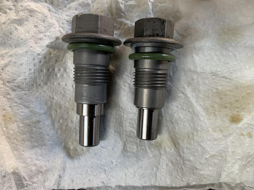

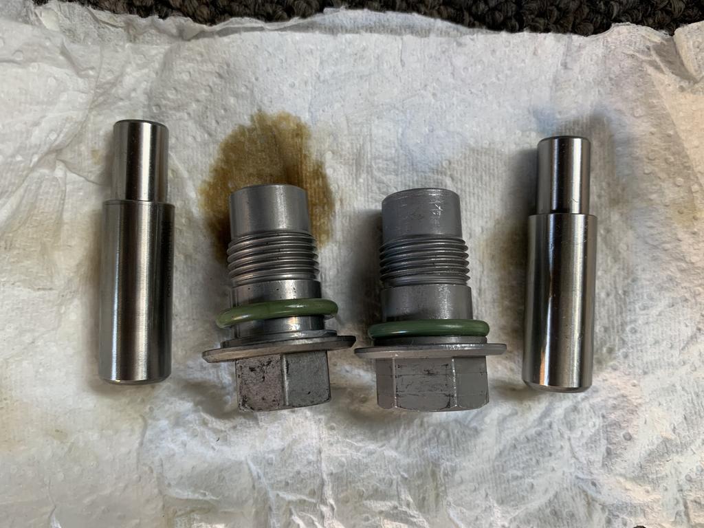

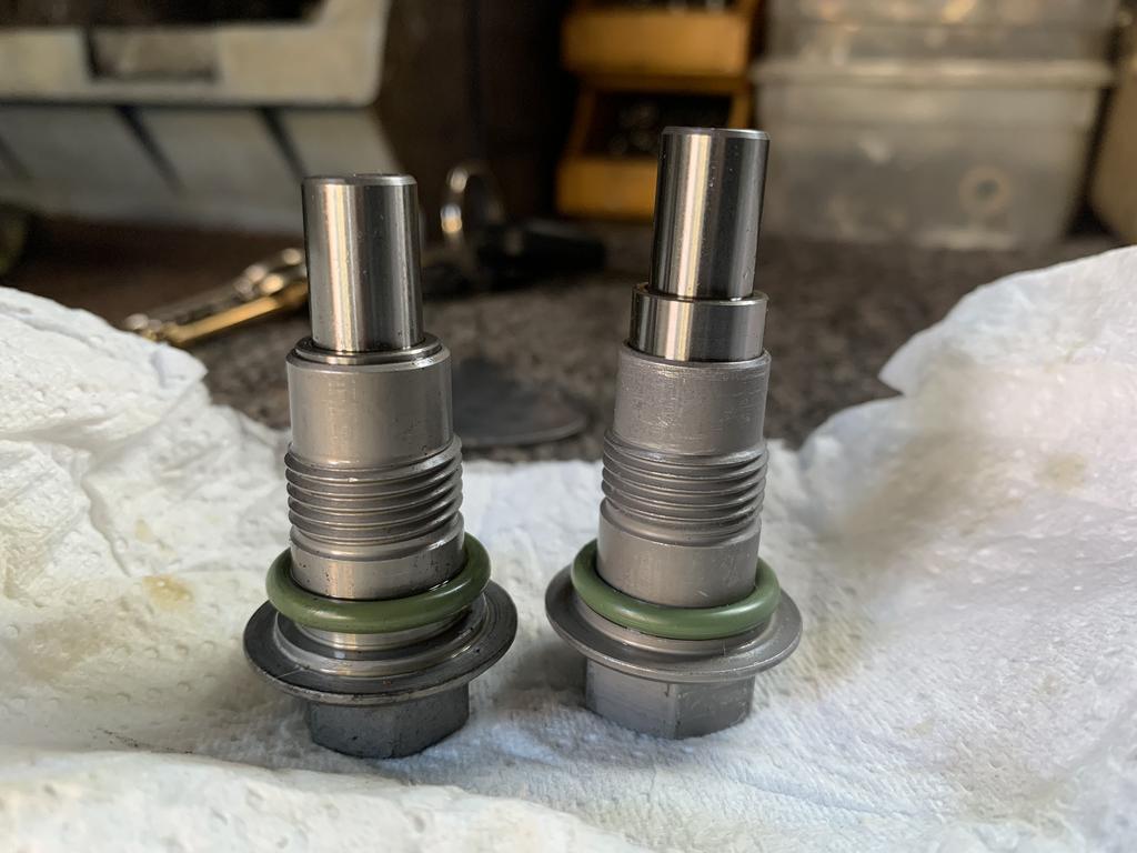

The tensioner isn`t a service item per se more of a small design improvement by BMW to address the tendancy of the 1200/1250 engines to emit some unwanted rattle noise from the left hand cylinder at idle.
The tensioners on these bikes are part hydraulic, the new design has the same length plunger but it does not insert so far into the body as the old type (it sticks out more...) which i assume imparts a little bit of extra force on the tensioner blade to minimise this rattling when the engine speed is at idle and the oil pressure low.
The original tensioner has a 17mm body, the new one 19mm.

They can do
Mine had new cams, tensioner and timing sprocket assembly under warranty, can’t remember which side
Maybe @MotoRevive can confirm but I’m fairly sure there’s only one part number for the 1200 LC tensioner
I replaced mine and its slightly less rattle on the 1200 using the oem part. There was s very slight difference in finish and the spring felt a little stronger but i think most 1200 wc,s i heard all sound a little rattle at idle if warm
