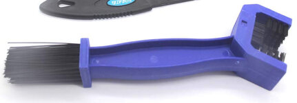

Micky Never knowingly understood UKGSer Subscriber Joined Nov 13, 2005 Messages 25,466 Reaction score 6,760 Location South Yorkshire Jul 20, 2019 #9 Just be careful that any brush you use doesn't have any sharp bristles I used one of the Oxford ones and the bristles were so stiff that they were cutting the 'O' rings I now use a cut down soft paint brush. A tinfoil baking tray under the chain collects most of the paraffin ... Paraffin OK Attachments Chain brush.jpg 120.1 KB · Views: 395
