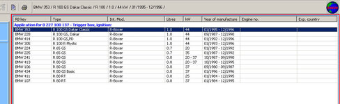

Anyway the Intermotor 15000 and Lucas DAB400 are indeed one and the same part. I can confirm that. The Lucas DAB126 is completely different although the plastic case is similar. It has, as pointed out, 4 pins not the 7 of the 15000 and is anyway different electrically.

I’ve also attached a picture but don’t know where in the thread it will appear.

PS I looked up that coil number. I don’t think we do that unfortunately. According to my Bosch catalogue it only fits BM bikes hence we’ve never investigated it.
