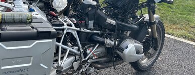

Something looks odd about the bash plate. In one photo, towards the end of the shots, it has the steel mounting plate still attached? Or did you re-attach this after? Normally when removing this it's literally only the Ali plate in you're haha, leaving the rubber mounts on the engine...
The ali plate looks correct, looks the same as a GSA plate - but yours is a GS, so unclear if they're identical parts?
Did I mention I still need a new lid and gloves? Honestly, you’re watching a lad paying his way back in. If I don’t
It's actually part of the the engine bars. It had a big brace in front of the alternator cover and also the one you noticed. The bars used that double brace as a mounting points.

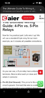

It would appear I’ve this plugged wrong? Red is plugged into 87a. That is an always on circuit that is closed upon key on? It should be the one below? Correct? As in that does not become live until the relay gets a signal from key on?
If I wire spots in and want them to turn off with key off, I just wire the negative to the battery and add the positive to the relay 87? I think that is the way it was ten years ago…

That mystery red wire might be something to do with the starter/relay circuit. There is a permanent live wire to the relay on the starter, but they are known to degrade and drop voltage to the point it doesn't do its job and the bike won't start. The easy fix (which I did around 9 or 10 years ago) is to connect it directly to the battery. So that might be the old wire cut and now disused, or the new one no longer attached to wherever it should be.
You also mentioned the brake servo on your bike. It has iABS2, no servo fitted.
Good luck!
The red wire comes from the loom. From what I can gather, it should be attached to 87- this is a 12 v feed that switches on when the key is turned on. I think it feeds to 12v accessory socket on the beak? Previous owner had a strange double space connector that fed the spots power. Not sure when the red wire fell out but don’t think it would affect starting the bike.
