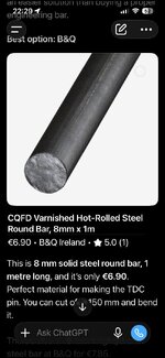

Question regarding the valve adjustment. Watching a Max Bmw video here.
Do I need to change the inner gasket? They say I do and I believe them but didn't order any...
Another thing. Is there no inspection window on the 1200's? When I did this before I had to remove a rubber grommet to reveal where I could line up TDC? Going to go rooting here but a bit surprised videos using screwdrivers and lengths of aluminum rod?
EDIT things have moved on with the hex heads! So I just need to get a round rod that is 8mm in diameter... that'll be a bit of a treasure hunt!
Edit edit : I have to go to b and q anyway to exchange a few bits for the utility room build that is 95% finished!
