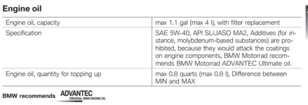

The bmw r1200gs lc hand book page 223 states 5W40 - other viscosities might be ok but BMW are specific.

It doesn't say they 'might be okay'.
It recommends 5W40 because their aventec 'ultimate' fully synthetic motorrad oil only comes in that grade. And that's the only fully synthetic oil their dealers are allowed to sell.
So it advises you to buy their own very expensive oil but it also lets you know that you can use a whole range of other oils quite safely.
The W number has no relevance once the engine is warm anyway.
I'd use that. It's to spec.
