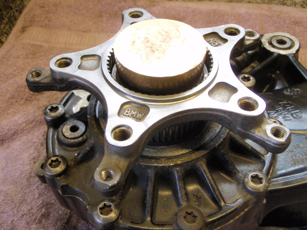

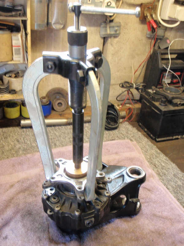

Those flanges are a very tight fit and require some sort of extraction device and adapter.
This is how i got mine off;

I have put the crown wheel in the freezer and the flange in the oven , a quick assembly so they go together easily.
I have not noticed a stop but never looked, just made sure it was together enough to get the circlip to fit.

Probably the fastest method, go down to Hurst ASAP with the bike with that section as clean as you can get it
They have the kit to extract the flange off the drive splines BUT it's easier to do it on the bike

The flange just needs to go on all the way (iyswim)
As Chris has said above,if the crown wheel assy is put in the freezer for an hour or two,then the flange heated to @180 deg it will drop on,but be quick about it and do it in one smooth operation.
