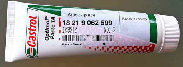

I use the correct grease (£20 for a little 50gm tube) which has the thickness of Sudocrem and is very sticky too - some are too tight to buy the right sealing grease; maybe that's causing some of the reported issues?
Maybe that's why I haven't suffered water ingress on recent bikes - I did on my hexhead where some numpty didn't fit the internal spreader clip and the joint snapped, locking the wheel.
Isn't that for the splines, rather than the sealing?
I have the Optimol too - very different to the correct sealing grease.
Yep, that's the stuff. About £20 for 50gm.
Some would rather spend a fiver on a 500gm tin of moly grease in the hope that it will job, rather than 25 times the price on the specified and researched product. :nenau
Yep and this is the actual OEM stuff BMW use for the gaitor sealing.
https://www.ebay.co.uk/itm/GENUINE-...091459?hash=item1cd3898d43:g:StEAAOSwDNRcr6BQ
Actual price of both items needed with part numbers oem BMW
Schmierstoff Staburags NBU 30 PTM 50G (07559056992) 18,71 €
Montagepaste 100G (18219062599) 13,90 €
