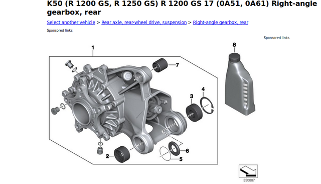

I was out today (fitted some new Conti Tail Attack 3s). Got home and pointed the thermometer at all the usual parts... this is becoming a habit . FD was- again - 40.5° with the gradual rise in temp as you move up the swing arm finishing with a gearbox at 73°. So no changes.
My riding was part motorway then finishing with light local traffic.
Interestingly, I decided (while it was all 'hot') to feel for any play in the FD by push/pull on the wheel. Slightly to my horror, I could feel play at the 12/6 o'clock position and zero play at the 9/3 o'clock position.
I went out when it was all cooled down (early evening) and there's now zero play in either position! I'm gonna replace the fluid at the end and see how it looks...

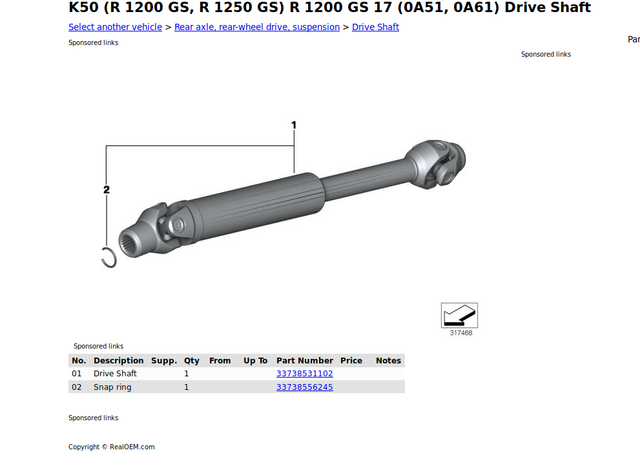

Well, getting some advice from JVB after viewing his vid and using a scissor jack under the disc to hold it (great tip Smogbob :thumb2 ) , levering the shoe back I could see the male end of the spline in the U joint. I dropped it just enough to angle the spline upwards without letting it come out at the gearbox end and sprayed a little wd40 onto the male spline, let that soak overnight and then some more with a bit of a wiggle this morning. So when I got back from work this evening using a screwdriver in the rearmost u joint and lowering the disc with the scissor jack ..Bingo.. Houston we have separation. Not nearly as much rust as warlords but the splines had a good deal of surface rust hence them sticking. Cleaned off rust and all now greased up. Happy the top end is seated correctly and good to go. Thanks for your help guys well worth my 12 squid!
