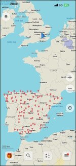

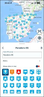

It loads straigt into one’s own POI library in MyRoute, too:
PS It assumes they are all in the correct location.

In MyRoute, it’s important to get the level of zooming in and out right, to get the parador Points of Interest to appear on the map. I was wondering why I couldn’t see them this morning. Now I think about it, it’s the same with the POI points that are preloaded into the MyRoute app.
