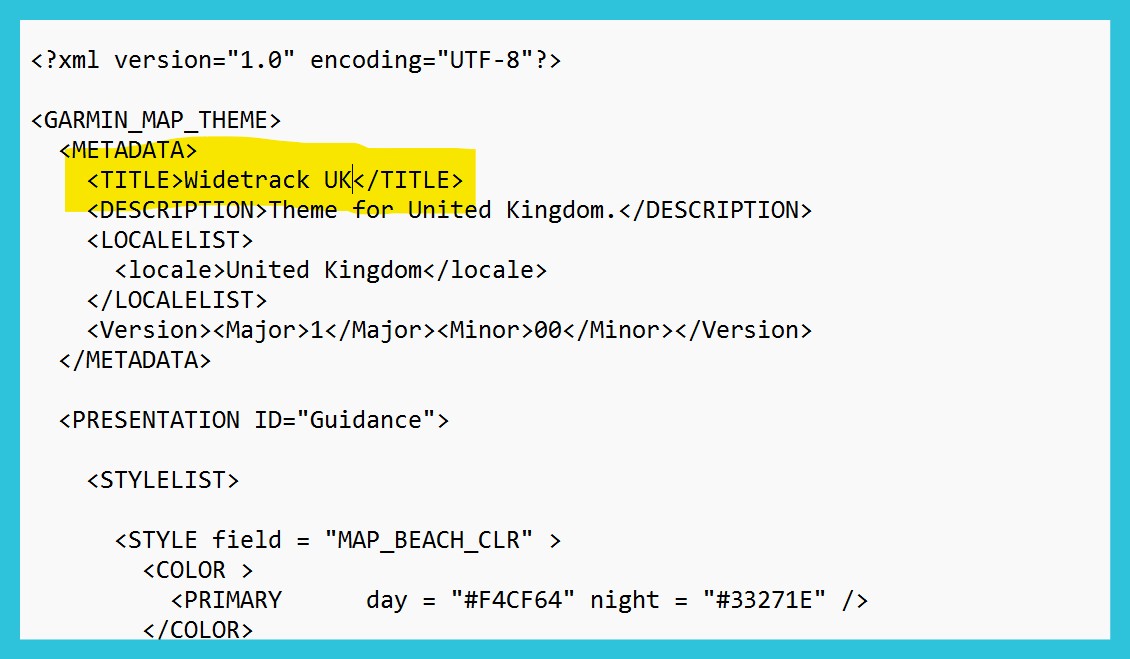

If I can add one thing... It is worth changing the title/name of the theme - to make it clearly different when selecting a theme in the XT settings menu.
This is in the same file - near the top:
