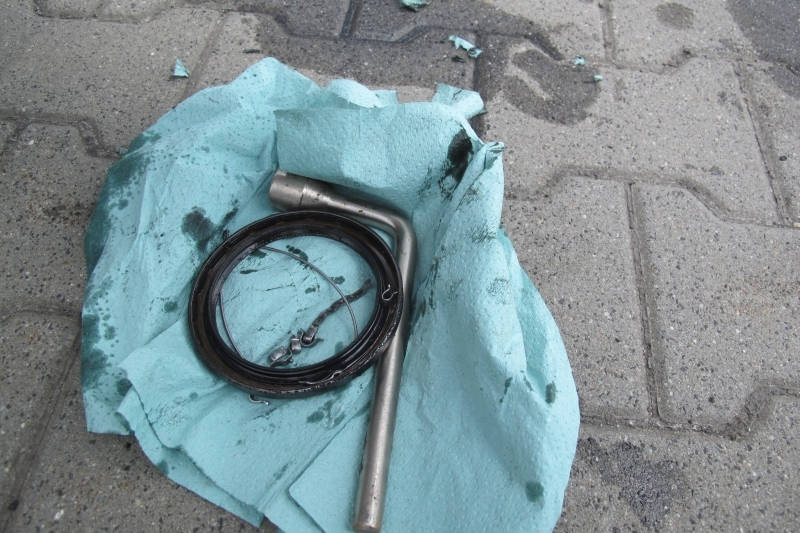

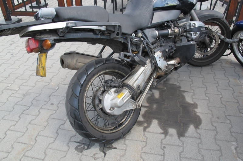

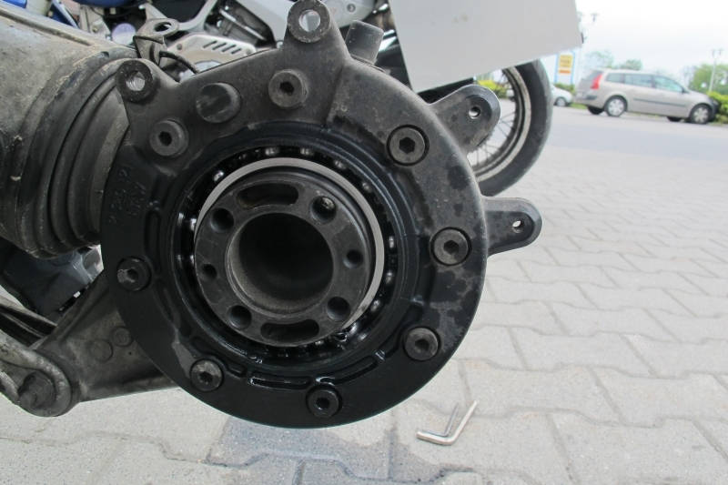

In the BMW repair manual it explains the process for checking the shims.
The bearing is 85x120x18 of the 'grooved ball bearing' type and the seal is 85x110x10
ok that makes the bearing a 61917 probably c3 type.
Anyone know the part numbers for these bits ?
[, new bearing and seal ordered from Motorworks, as they're significantly cheaper than BMW, and quicker.
