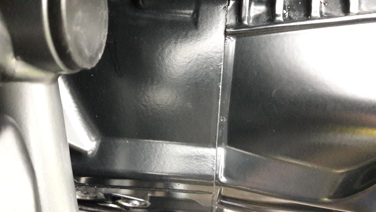

Is this the start of a new engine claim?

R/H Cylinder. No other marks anywhere else on the bike. 16 reg Triple black......
Not sure, but I understand they're now they're rebuilding with new cases (using all the original internals), rather than fitting whole engines.

It came direct from a customer of Vines as that's what he was offered. As Gerard said, maybe depends on circumstances.
Mine had a short engine - old heads, but new below.
Definetly corrosion. I had my engine replaced with similar.
I paintbrush acf50 along all vulnerable areas now as bike out of warrenty. Works for up to now.
I was in CMC Cannock last week and spotted a 16 reg TB. I noted all the rust spots so I could check it against mine and apply more ACF50. :D I was surprised to see on the showroom bike the bolts on the exhaust hanger bracket had even started to rust.
If you wander around your local BMW dealer, engine corrosion is probably visible on 50% of the used bikes to one degree or another. I was in my local dealers last week and there were loads of used LC models for sale (RT and GS) which had far worse corrosion than the engine which was replaced on mine.
I guess engines or casings are only replaced if/when the owner complains :nenau
Well, BMW have told the dealer to replace the engine casings. They want it for 10 days! I really don't want my engine pulled apart and put back together, who knows what could go wrong.... Anyone had it done yet?
Had mine done 3 weeks ago, would have taken 2 days ,but for the tech noticing some bolts were different from a bike he had done the week or 2 before, discovered bmw had started using once use bolts,which had to come from Germany. Dealer not sure why this wasn't noticed when they ordered the casings. All in 4 days ,bike seems to be running very good

Replaced Engine Castings and Driveshaft
My 65-plate 1200GS went in 2wks ago to have the engine casing and driveshaft/hub replaced.
Picking it up on Fri, so will be able to see how it looks and run. Dealership has been very helpful and kept me regularly informed, but do have a bit of a worry, since as others said - hope it was all put together properly.
