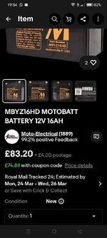

They seem to be available via eBay. Less than £75.00 if add the discount code at the checkout.
