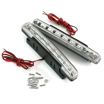

just a quick one, could anybody point me in the direction of small LED light bars that sit in front of the oil cooler? there was a GSA i seen as williams in manchester the other day and it looked the nuts.

These shouldn't break the bank
http://www.amazon.co.uk/RHX-Driving...=1426870021&sr=8-1&keywords=led+day+light+car
Would these upset the canbus bulb monitoring if wired into the lighting circuit?
8 x 2 = 16 LEDs drawing about 20mA apiece.....say 320mA ish.
Nah, should be fine. Won't harm. If anything hinky occurs then run them via a small relay.

Wire them to dip beam via an LED dimmer so they won't dazzle. Then run a wire from main beam supply that bypasses the dimmer module.
That will give low lumens no dazzle daytime running lights to work with dipped beam then hit main beam to get full lumen output.
Many so called narrow angle LED spot lamps are 30 degrees which is pretty much dip beam spread. Something like 20 degs or less would be good to work with the main beam.
To get all that working properly will need a relay on the main beam but they are cheap and easy enough to wire up.
