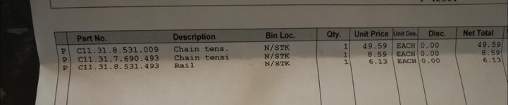

Thanks for posting mine's only approaching 20k but noticeably louder than it used to be. Whats the parts cost roughly?
Less than £80 for the two blades and tensioner, from my dealer. Motorworks same price to the penny.. The tensioner was £57 approx.

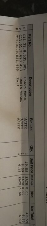

Part numbers and prices...
Here ya go.
Piccy above, gave me neck ache.. :D
:pullface
