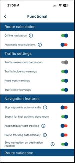

In the navigation option set the “ slider” on the offline maps option to “green”. This way you have the maps offline whilst still being able to use your phone for all data services
See screen shots from main menu

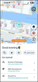

Last screen shot shows what you should have in the menu when you have your maps accessible off line. The orange banner
Provided you have downloaded the maps you need to your phone it will all work without internet connection.
