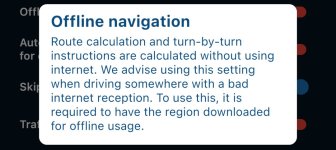

I forgot to mention I think the biggest restriction for using the app as an only device is the fact that in order to start a route you need to be "online" as a prerequisite which for me I was more or less the entire time, but without internet of some kind when you first open a route and press navigate, you're stuck. The app says it can do it, but it clearly doesn't work. After the routes been loaded in and you set off, if you then lose internet its fine, but it would be very frustrating to want to start a route, with all the offline maps downloaded, for it to then not let you calculate the route as you need the internet in order to do so. I assume all the heavy lifting is done on their end not on the device.
This is what the Offline mode says:
If I put it into Offline mode (I have maps downloaded for offline use) and then open a route I can't start the route due to the error:
And if I go into Airplane mode to simulate having no signal or data:
But annoyingly when I do this, it enters Offline mode and gives me the previous message about needing to be online, so if I tap Go online I then get the bottom error saying no internet etc etc repeat to fade. Obviously for me this hasn't been a problem but not everyone I travelled with has roaming data for their phone plans.
