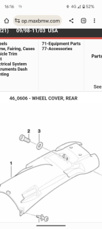

When you refitted the rear wheel, did you fit the washer, item 3. While it’s not necessary for non ABS bikes,(shim for the ABS sensor) it will shift the wheel 1-2mm left, which might be enough to clear that spot on the right side of cover.

I don't recall seeing a shim (I've had the wheel off a few times). I'll whip the wheel off tomorrow and have a look. The bike has ABS.
If it has ABS the shim should be fitted. I think its purpose is to centralise the disc in the caliper, because the disc is slightly offset by the ABS speed sensor disc on bikes with ABS fitted.
Will I have to re-shim the ABS sensor?
The washer will take the ABS signal ring further away from the end of the sensor.
So probably not, but it depends on whether you have shims fitted under the sensor. If you have then you will be removing shims not adding to maintain the correct sensor gap.
