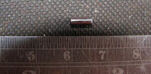

Having a tinker with the bike post 2500 miles in two weeks, and before the trip it had a period of venting gearbox oil into the driveshaft tunnel as the notch didn't have any sealant on it. So I thought I'd see how the sealant was bearing up, and so undid the rear gaitor and drained off a tablespoon of oil = :)
Then had a look inside the tin and saw one roller bearing roller :eek: It measures 6.38mm by 2.5mm diameter. Tried turning the rear wheel and it doesn't feel graunchy to me, and had a peek at the UJ's through the front gaiter and nothing obviously amiss.
Nothing really noted that when warm ie after a couple of hours cruising at 70 mph in 30 deg c heat there seemed to be a gruffness at 3500 in top, but that might be due to the engine etc getting up to / close to over temping. And that happened in the first 500 odd miles.
So from those who've had the "pleasure" of pulling apart para drive shafts and the UJ's, is it one of them?
Piccy of the offending item below:

I recon its a roller from yer pivot on yer bevel box
Mine was knackered when I took it to bits after finding the same :thumb2
Wish I had measured one of the rollerpins then we may have made a more definate dyagnosis
they are in a flimsy basket/cage
Wait a while for some proper expert opinion but
I removed back wheel chocked up paralever and suported bevelbox
remove the ruber cap and warm with a hotair gun the threadlocked locknut on one side and the 12 mm allen keyed nut on tuther ( that one is super tight with locktight ) remove one at a time and inspected = one had dropped to bits
I would get a set of new uns on order and do the job anyway - dont think they cost that much about 15 quid
Like I said wait for another opinion though John
HTHY :thumb2

Confirmation I Think
I had a rummage in my 'used parts tin' and found an old, damaged Paralever Bearing.
I took it apart and measured a roller . . .
Length = 6.39mm.
Diameter = 2.48mm
So, it looks as though the loose roller came from the Paralever bearing as suspected :thumb2
The rollers are held in a rather flimsy nylon cage (I damaged mine by mis-aligning the pin when threading it back in :blast).
The cage is retained by a lip around the outer track. The bearing would have to be very slack / worn to allow a roller out if the cage was to break up. In other words, there should be some noticeable play in the paralever before the rollers start escaping.
This pic shows that the roller is wider than the visible part of the nylon cage.
If there is no noticeable / detectable play, I would suspect that the roller has been left over from a previous repair (wishful thinking, I know ;) ).
Hope this helps.
Bob.
